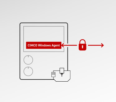

CIMCO Windows Agent replaces shared folders with a dedicated communication service running directly on the CNC machine.

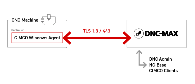

Instead of exposing the local file system, the agent establishes an encrypted point-to-point connection between the CNC machine and CIMCO software components such as CIMCO DNC-Max and CIMCO clients. Communication is handled over a single configurable TCP port using TLS 1.3 encryption, allowing integration in networks with strict firewall and security policies.
Here’s how it works:
  • Agent runs locally on the CNC machine as a Windows application or Windows service
  • File transfer and status communication use an encrypted Ethernet-based protocol
  • Only one TCP port is required, simplifying firewall configuration
  • No SMB shares or direct access to the CNC machine’s file system
