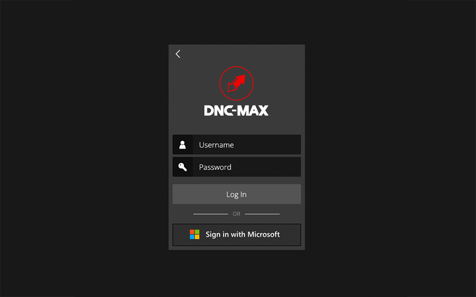

In DNC-Max, NC-Base, and MDC-Max, Entra ID can be used as a login method for both web and desktop clients. This means that users can sign in with their existing Microsoft account, either instead of or alongside local CIMCO users and On-premises Active Directory.

Once Microsoft Entra ID login has been configured, users will see a Log in with Windows button in the login dialogs.
