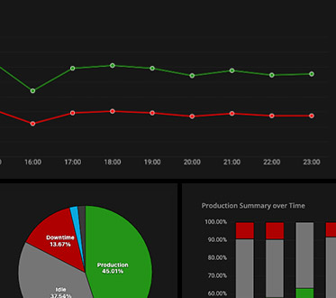

Analyze historical production data directly in the MDC-Max Web Client
With Historical Dashboards in MDC-Max, users can move beyond live monitoring and analyze historical production data directly in the browser.
On the shop floor, decisions are rarely based on what is happening right now alone. To keep production stable and predictable, it is just as important to understand what has happened over time, identify performance drift, and see when adjustments are needed before small deviations turn into real problems.
Historical Dashboards in MDC-Max provide direct access to production data in the browser, without exporting data or switching between applications. This makes it easy to check whether values are within expected ranges, compare recent shifts or days, and analyze trends across weeks, months, or years.
Dashboards are configured to match how data is used in production. Machines and time ranges can be selected freely, and data can be shown as charts or tables depending on whether trends or exact values are needed. Layout and widgets can be adjusted to fit individual workflows and work environments, so information is clear and immediately usable when something requires attention.
