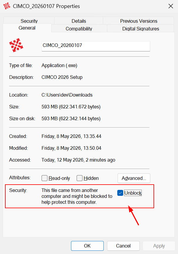

If “Run anyway” is not available
In some environments, especially on company-managed computers, the Run anyway option may be disabled by group policy.
In this case, you can unblock the installer manually (see image below):
  1. Right-click the downloaded installer file
  2. Select Properties
  3. In the Général tab, locate the Sécurité section
  4. Check Unblock
  5. Click Apply, then OK
  6. Run the installer again
